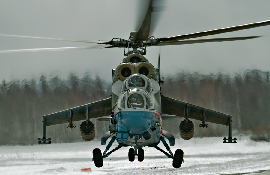

900
http://www.photovolk.com/images/photos//9ba402e9.jpg
